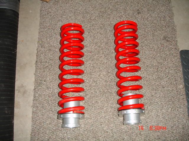

Lookie what i got. Who wants to help me install them? I have no space, little exerience, and even less usable tools. But i have two somewhat usable hands.
