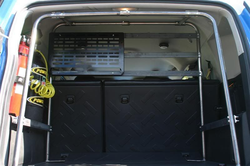

Yes, I am somewhat obsessive.
This is a photo of the new SCORPION Gear Storage Rack. You'll note that the rack itself is still a bit "rough". That's because it's a prototype that I'll be testing and improving over the coming month or two. It is an endoskeleton that provides for hard points throughout the back of the FJ that you can cinch to and opportunities to hard-mount equipment to the rack itself.
A shotgun rack (not in photo) fits facing the passenger compartment (forward) from the top cross-bar that you can see in the photo. In this configuration a Jeep TJ M-PAC rack is installed. You can also install the Springtail M-PAC that goes on the rear door if you want a rack that crosses the back completely.
Stay tuned for more photos as I try to raise the bar for storing gear in the back of the FJ.
It bolts in/bolts out of the back of the FJ in about ten minutes. The mount is constructed of 1/4 inch steel wall DOM (1" diameter) and 1/4 inch steel strapping.

Dang L..............that is very nice! Bravo!
Looking forward to seeing the final version!

Lookin good, I can't wait for the final version...I'd be very interested!!!

I added two 9" Quickfists to the rack to support the weight of the 20 lbs. CO2 tank
The larger than standard tank is there because on a long trip (like the Summit and the after-Summit run) I want to have enough gas to re-fill the tires several times. I also want enough to run my air-tools in the event of a problem on the trail.
I'm experimenting with "the best location" for things stored in the back of the FJ now. Here is an example of one solution for the recovery strap (pictured). It will additionally hold 300 feet of rope and the tree saver strap. There are more examples coming.

We are SERIOUSLY thinking of making the Scorpion Rack out of STAINLESS STEEL. They'd be manufactured in China, which means that we can do it and make the final product affordable. The rack on my FJ is a prototype only, suitable for field testing and tweaking so that when the finished product comes out, it meets the demanding standards of the FJ community.
The M-PAC racks and the Scorpion Rack, which incorporates additional M-PAC racks increase my interior storage capacity by about 25%.
G
I like the adjustability of the rack, being able to do pretty much anything with it according to your own personal needs. Very nice indeed.
