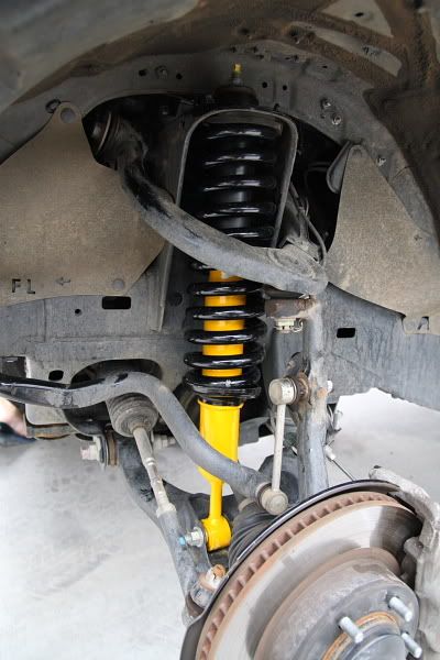

I ran over to AutoZone to rent spring compressors. They loan tools for FREE ;D I got back around 9AM and we got started. The install thread was valuable but not everything always goes as planned. After following the steps of the thread, we got to the point of compressing the new springs on the new struts. The compressor I rented worked with the OEM coils but did not fit at all on the OME coils. We headed over to his mechanic and used their professional spring compressor. It had always been advised to get the coil overs assembled at a shop and I'd have to suggest that is planned for as well for future do-it-yourself folks. I tipped($) the shop owner for letting us use his tools.

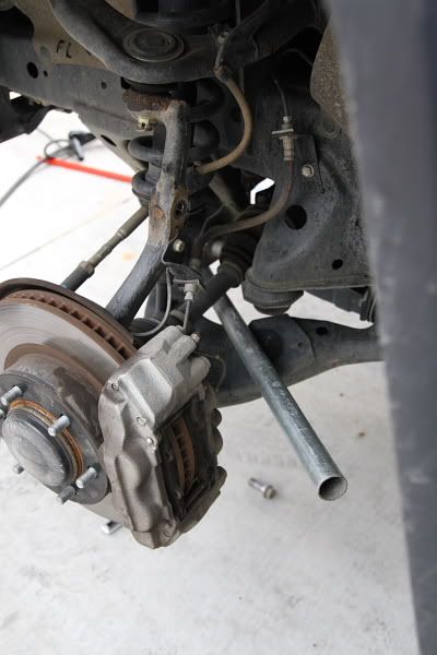

Everything else in the thread was straight forward. Putting the strut back in the LCA was a b**ch but using the tire iron of the FJC helped out a lot to move it all back into position. In the beginning, the thread was very detailed with torque specs but torque specs started to disappear closer to the end. I just found the torque specs for the rest of the bolts and will double check my bolts later today.

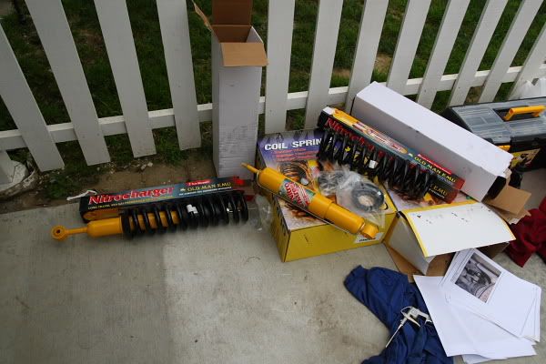

The stuff:

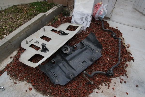

These were removed to get started. That's Mudloving's old bling plate by the way:
How we moved the LCA around:
Installed:
