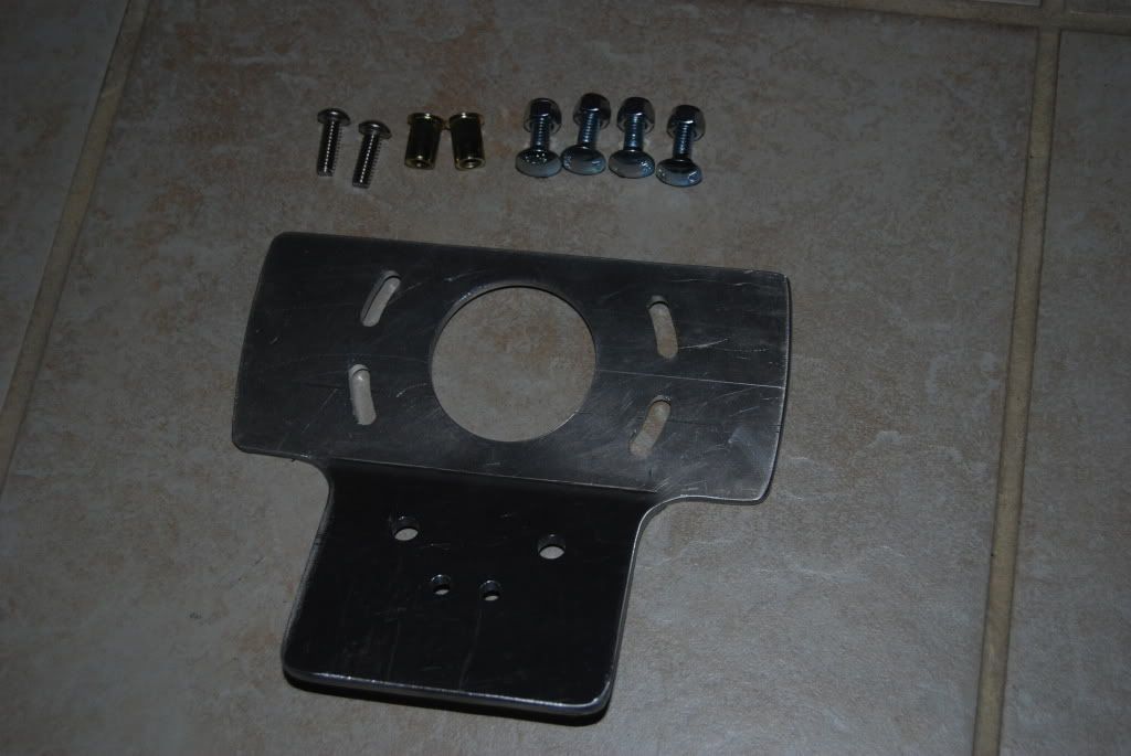

Well Me and Jack from Jackfab have come up with an uber clean and solid overhead GPS mount. If you paint it grey almost looks stock. It is made from 1/4 laser cut aluminum precisely designed on cad. The bend is impecibly perfect to match the contour of the headliner. Also we have incorperated threadserts into the truck that will make this design infinitly stronger than the mounts held up by the 2 mirror screws. It also allows the unit to be swiveled side to side as well as the already up and down option that came with the gps. Included with the mount will be hi grade hardware and the threadserts. At 50 bucks They are a little pricey but totally worth it. There will be a cheaper version made of thinner powdercoated steel availiable in the future. These are specifically made for the lowrance baja but can be adapted to anything from a bluetooth to a ham/cb unit or whatever you can want up there. Installs in under 10 minutes. Also you can keep your rear view mirror if you want although it may be somewhat obstructed depending what you put up there. PM or call me if interested.

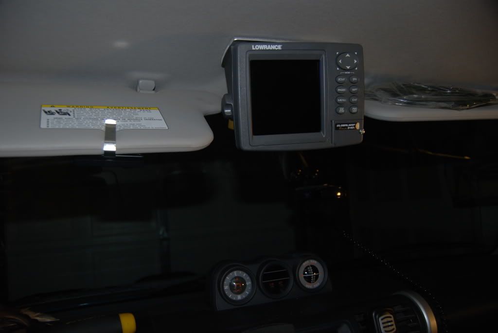

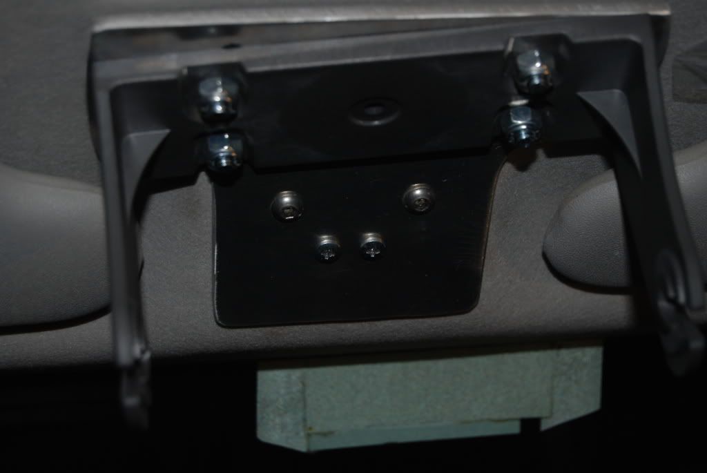

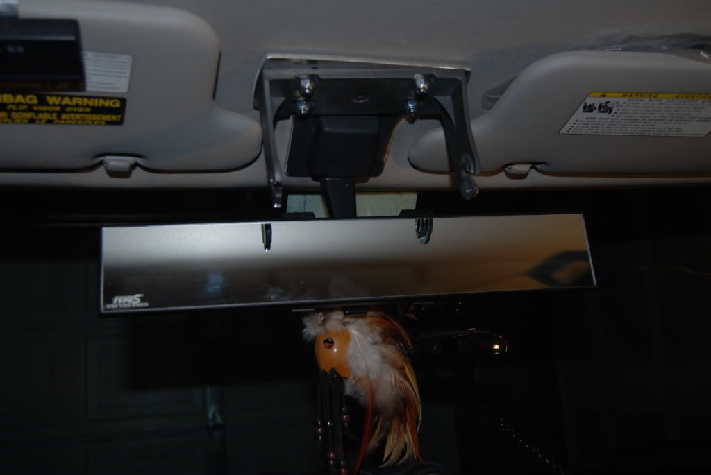

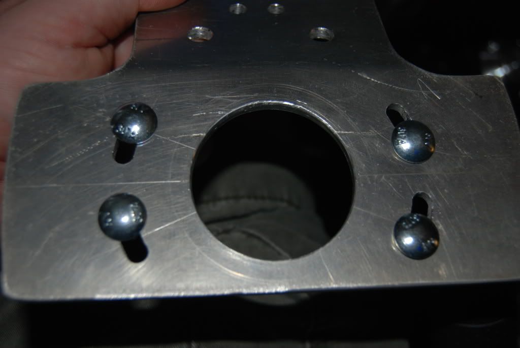

OK heres what it looks like and the hardware. I decided not to paint mine, I like the raw look

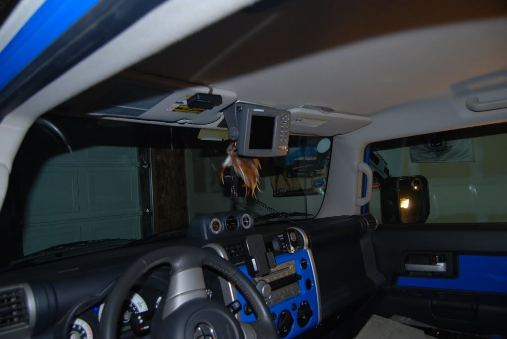

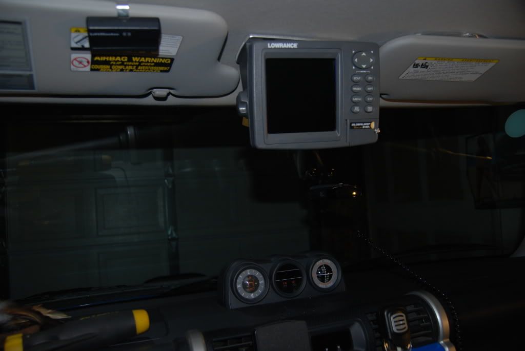

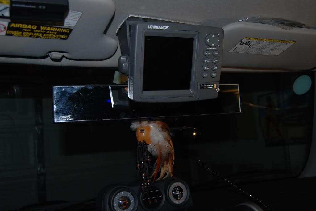

Here's what it looks like installed.
it clears the visors

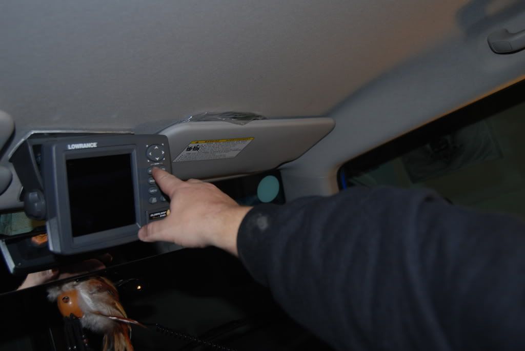

Also I can reach the buttons while my shoulder still on the seat back, no leaning and reaching.

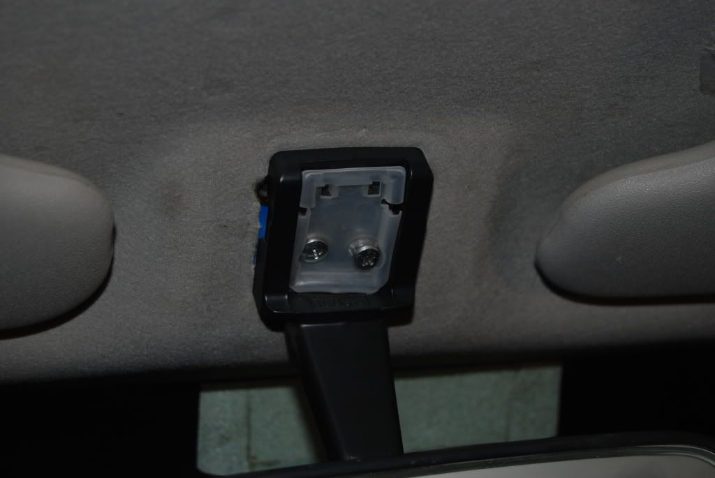

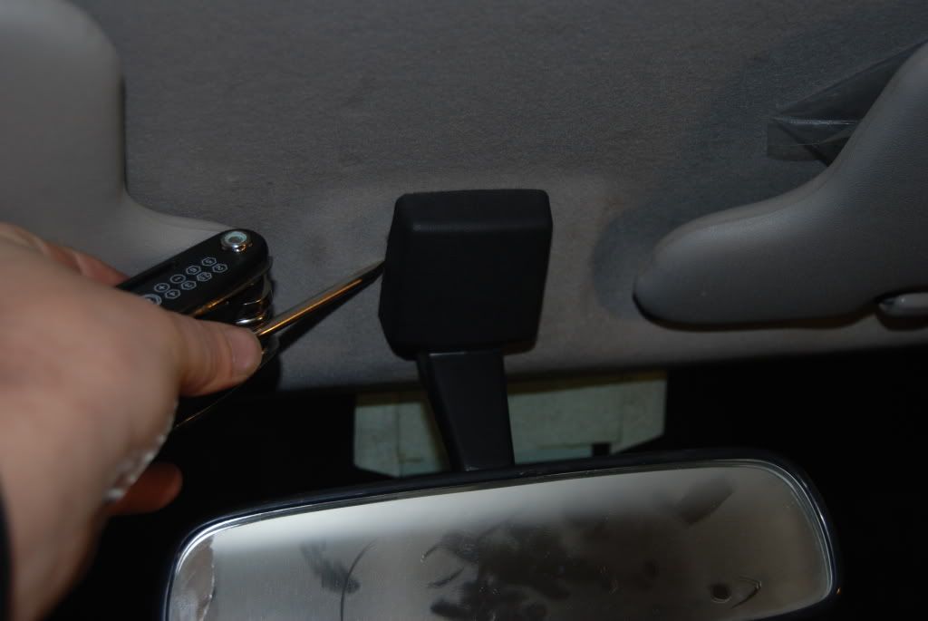

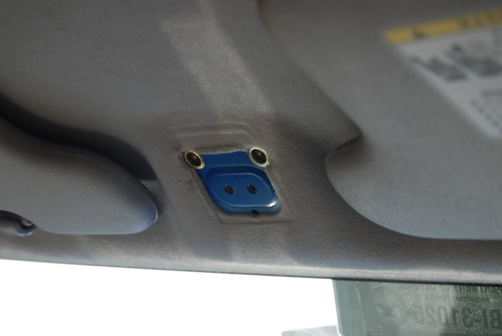

Step 1 remove the rearview mirror by poping off the mount cover with a flat screwdriver

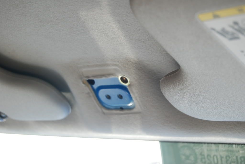

Step 2 remove the 2 screws that hold the mirror on

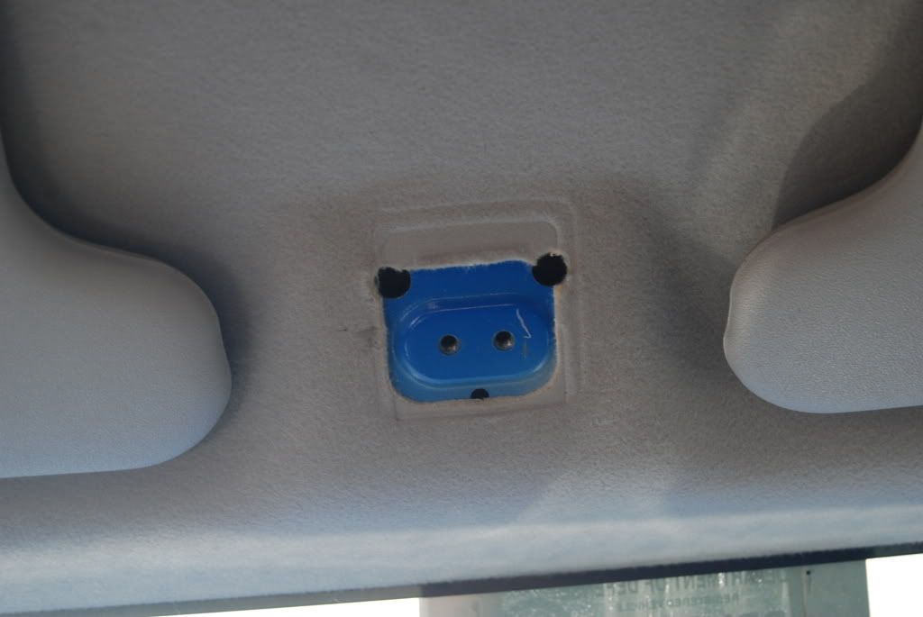

Step 3 with a razor knife cut away a small amount of the headliner where the top 2 holes are to fully expose them.

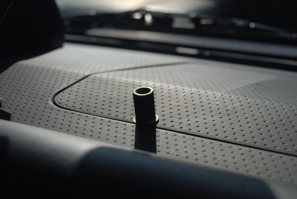

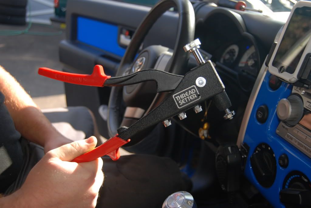

Step 4 get a threadsert tool, 10 bucks at harbour freight or borrow one from an auto shop.
Now screw a threadsert onto the tool and place it into the hole and squeeze, try to make sure you get them as flush as possible.
Do this for both holes.

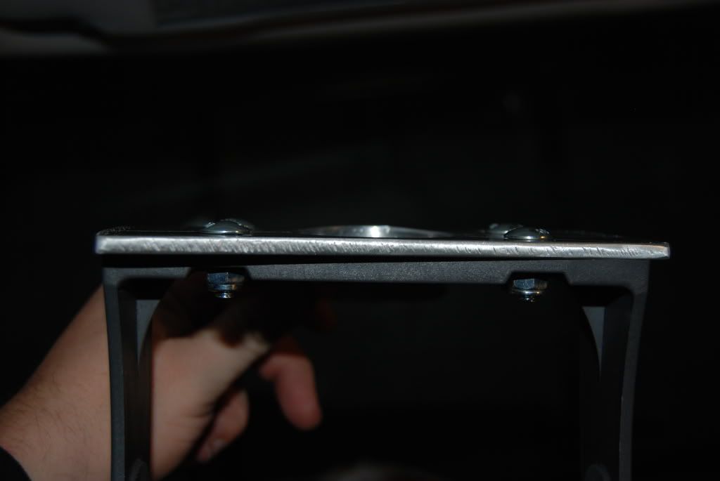

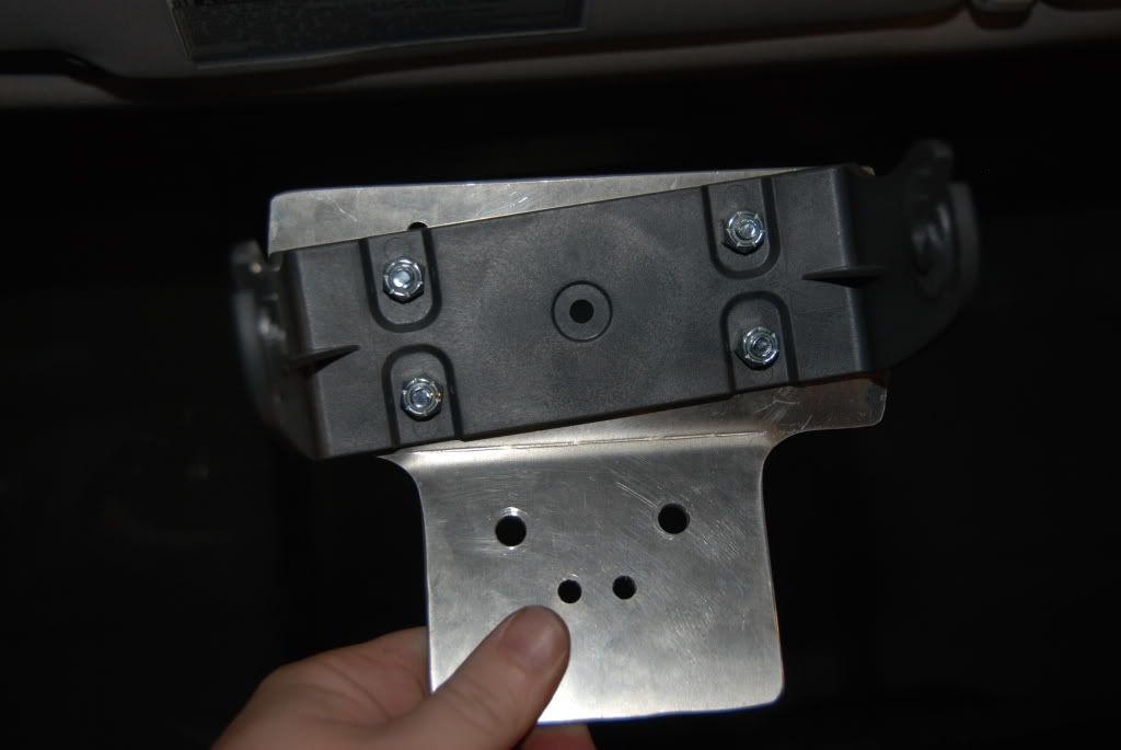

Step 5 assemble the Lowrance bracket onto the mount by inserting the carraige bolts through the top of the mount, and putting attaching the nylock nuts on the other end. Make sure you have a pretty good idea of the angle you want on it or you will have to loosen the nuts and re adjust later.
Step 6 Attach the mount to the roof. Always loosely install all bolts and screws first so they all line up before snugging them down.

If you run the mirror or not that is up to you. The final step is to install the unit. Pop it in, adjust the down angle and tighten the side knobs and Violla.
