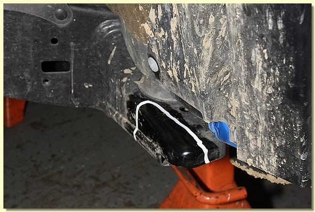

Pictures and instructions on a body mount chop with no welding required.
Before cut:
1. Mask area that you plan on cutting.
2. Make a carboard template to make the steel template.
3. Fit steel template in hole align steel piece.Fill edges with quick steel.
After cut 1 inch + on space.
4. Sand & paint will post pics later.
Before cut:
