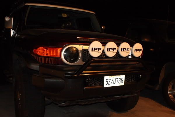

Here's the new nose:
I blacked out my front bumper parts a couple weeks ago. I bought the Aeroflow light covers used from a blue room member. IPF lights are from Costco (thanks for the tip Fjamming). After admiring Dragon's Taira for so long, I picked up the Rampage Dakar lightbar from Dirty Parts. The install took me a while mostly due to the poor instructions from Rampage and the lack of instructions on the Internet. I didn't take pictures during the install cuz I was running out of sunlight.
I still need to wire the lights and make bar and light position adjustments. I'll do that sometime before the weekend.
I'm tired.
How's it look?

Thanks guys.
looks great Eric!
Dom, there has been some question regarding the Lucrum and the Dakar bar fitting together. The Dakar bar mount uses the 6 outer bolts of the inner metal bumper to the frame. Does the Lucrum mount to the same area?

Ok. It looks like the brackets that hold up the dakar bar will need to be trimmed to go around the triangular metal plate above the three bolts. It doesn't look impossible. Wow....I didn't know the Lucrum totally removed the from cross member.
Thanks Dom.
You would be referring to the stock metal bumper, or crash bar, not the cross member ;)
